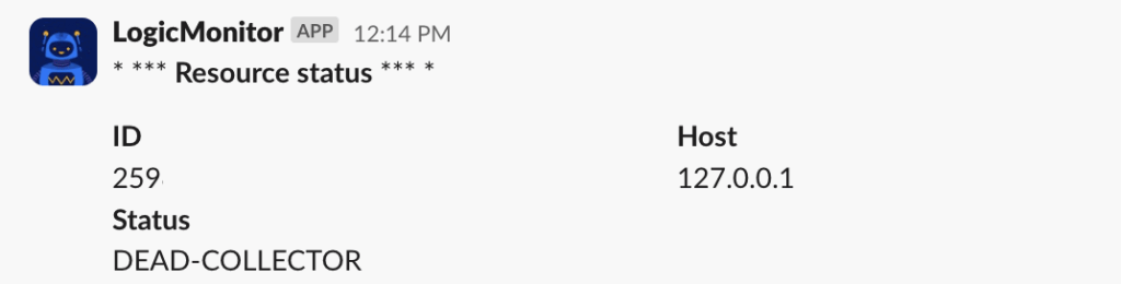

Slack channel with LogicMonitor alert

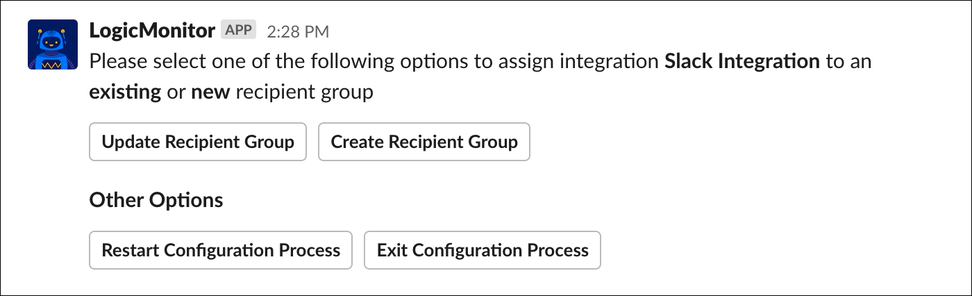

Assigning Your Integration for Slack to a Recipient Group
There is no requirement to make your integration a member of a recipient group in order to have alerts routed to it; you can optionally directly reference the integration from an escalation chain if it doesn’t make sense to group alert delivery to Slack with other alert recipients. For more information on the logic behind recipient groups, see Recipient Groups.
However, if a recipient group does make sense for your integration, follow the next set of steps to add your new integration as a member to a new or existing recipient group.
  1. Click the Assign to Recipient Group button to begin recipient group configuration.
  2. Indicate whether you’ll be adding this integration as a member to an existing group or whether you’ll be creating a new recipient group.
    • Update Recipient Group. To add this integration as a member to an existing recipient group, click the Update Recipient Group button and, from the Update a Recipient Group dialog that displays, select the recipient group from the provided dropdown. Slack limits dropdown menus to 100 selections, listed in alphabetical order; if your desired recipient group is not present due to this limitation, you can enter its name directly in the field below.
      Note: By adding this integration to an existing recipient group, all escalation chains currently configured to route to that recipient group will automatically begin delivery to your integration. This means that there may not be a need for any additional alert delivery configurations.
    • Create Recipient Group. To add this integration as a member to a brand new recipient group, click the Create Recipient Group button. From the Add New Recipient Group dialog that displays, enter a unique name and description for the new recipient group.
      Note: A brand new recipient group will eventually need to be assigned to an escalation chain in order for alerts to be routed to its members.
  3. Click the Submit button. A new message displays to indicate successful assignment of the integration to the new or existing recipient group. The recipient group record you just created or updated can be further edited in LogicMonitor by navigating to Settings > Alert Settings > Recipient Groups. The success message also prompts you to optionally assign the recipient group you just edited/created to a new or existing escalation chain. Remember, if you just added your integration to an existing recipient group, you may not necessarily need to perform any escalation chain configurations as all escalation chains currently configured to route to that recipient group will automatically begin delivering to your integration. If you added your integration to a brand new recipient group, the new recipient group will eventually need to be assigned to an escalation chain in order for alerts to be routed to its members.If you’d like to assign your recipient group to a new or existing escalation chain, see the next section of this support article.

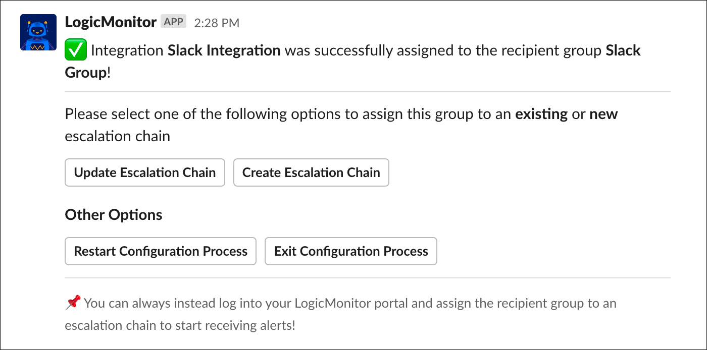

Assigning Your Integration for Slack to an Escalation Chain
From Slack, you can add your new integration (or a recipient group that contains your integration) as a stage in an existing or new escalation chain. For more information on the role escalation chains play in alert delivery, see Escalation Chains.
The configuration of an escalation chain from within Slack can be arrived at in one of two ways:
  • You chose to add your integration directly to an escalation chain immediately after configuring a new Slack channel.
  • You edited/created a new recipient group from Slack and are now adding that recipient group to an escalation chain.
Either way, whether you are adding your integration directly to an escalation—or a recipient group containing your integration as a member—the following set of steps is the same.
  1. Indicate whether you’ll be adding this integration/recipient group as a stage in an existing escalation chain or a new escalation chain.
    • Update Escalation Chain. To add the integration/recipient group as a stage in an existing escalation chain, click the Update Escalation Chain button.
      1. From the Update a Chain dialog that displays, select the escalation chain from the provided dropdown. Slack limits dropdown menus to 100 selections, listed in alphabetical order; if your desired escalation chain is not present due to this limitation, you can enter its name directly in the field below. Click Next.
      2. Select the stage to which the integration/recipient group should be added from the provided dropdown.Note: By adding this integration/recipient group to an existing escalation chain, all alert rules currently configured to route to that escalation chain will automatically begin delivery to your integration. This means that there may not be a need for any additional alert delivery configurations.
    • Create Escalation Chain. To add this integration/recipient group as a stage in a brand new escalation chain, click the Create Escalation Chain button and, from the Add New Escalation Chain dialog that displays, enter a unique name and description for the new escalation chain.Note: The integration/recipient group is automatically assigned as the first stage of the new escalation chain. Escalation chains can have multiple stages and advanced configurations; to build on your new escalation chain, open it in LogicMonitor.
  2. Click the Submit button. A new message displays to indicate successful assignment of the integration or recipient group to the escalation chain. The escalation chain record you just updated/created can be further edited in LogicMonitor by navigating to Settings > Alert Settings > Escalation Chains. The success message also prompts you to optionally assign the escalation chain you just edited/created to a new or existing alert rule. Remember, if you just added your integration to an existing escalation chain, you may not necessarily need to perform any alert rule configurations as all alert rules currently configured to route to that escalation chain will automatically begin delivering to your integration. If you added your integration to a brand new escalation chain, the escalation chain will eventually need to be assigned to an alert rule in order for alerts to be routed through it. If you’d like to assign your escalation chain to a new or existing alert rule, see the next section of this support article.

Viewing and Responding to Alerts from Slack
Alert notifications are posted to your Slack channel with summary information that includes alert severity level, alert ID, alert message, and other key pieces of information.
As discussed in the following sections, there are several actions you can perform from alert notifications in Slack, depending upon the type of alert.

Configure Slash Command
Creates a new integration or edits an existing integration. The Update Integration dialog opens if this command is entered with the name of an existing integration. Otherwise, the Add New Integration dialog opens.
Command: /lm configure [integration name - optional]
Examples:
  • /lm configure
  • /lm configure Slack Alert Integration
Note: This command should only be used once the initial app installation is fully complete, after the workspace has been linked to your company via creation of the first integration record.

Status Slash Command
You can use the following slash command to get the status of a resource.
Command: /lm status [device_id]
Example: /lm status 259
In Slack, the following status information appears when you enter the slash command with the resource ID.
